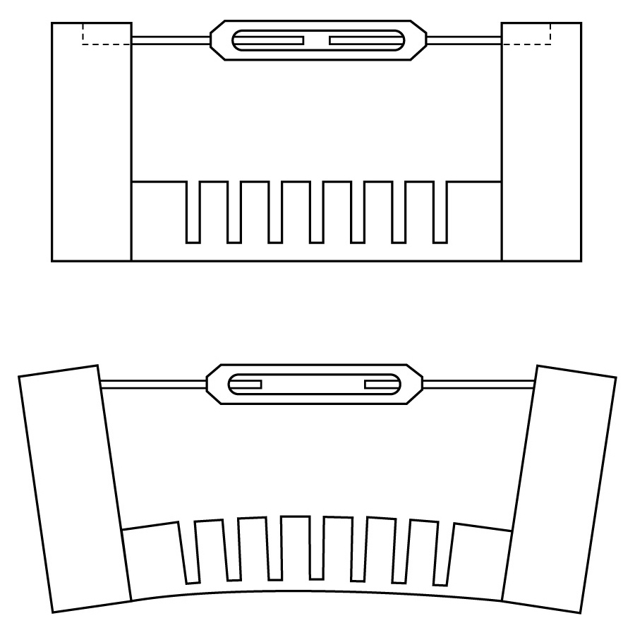

the first time I saw that sanding block I thought it was a good idea, at
least for fretboards with constant radii. I made one very quickly with 3
pieces of wood and 2 turnbuckles. Mine is about a foot long. I just stick
PSA backed sandpaper on the bottom and I can change the radius to
whatever I want. A little notch holds the "eye" ends of the turnbuckles and
a loosely attached screw keeps the eye in place. Here's a quick sketch:
Hope this helps.
Craig S.

That is a great idea! You wouldn't happen to have a photo too?
What is the approximate depth of the webbing? 1/8"? 1/16"? Does it present a smooth face or are there creases? Does any one wood work better than another?
The thing I really liked about the LMI version was the fact that it had a lot of heft. I suppose there are various ways to add weight to something like that. Lead weights or shot bags or something.
Well, now I feel stupid. Sometimes you become so caught up in the quest for something, you forget to ask "Can I do that?"
Thanks again! I would still consider purchasing one if it is out there but if not, this is the way I will go. You're a lifesaver Craig!

Craig, wonderful design! I think I'll have to build one of those myself.

I'll have to take a picture tonight (if I remember!). I have never felt that I
had to add any weight to it. It's surprising how quickly you can produce a
final radius. I don't remember how thick I left the web, but the sanding
surface is smooth, not faceted. I'll post a pic tomorrow.
Craig S.

Doh! Now it ilooks like I'm going to have to try a third time to do this. The first time, I made the web too thin and it broke. The second time I left the spaces in between too wide (I think) and I don't think there's enough room to cut bisecting kerfs. Today I'll go to town and see if I can find some small turnbuckles (I live in the sticks) so we'll see. Thanks Craig!

I'm thinking you could laminate some 1/32 birch plywood that you can get at a hobby store to the bottom. It would add a lot of strength and durability. You can get a 24" X 48" sheet herefor about $13.
